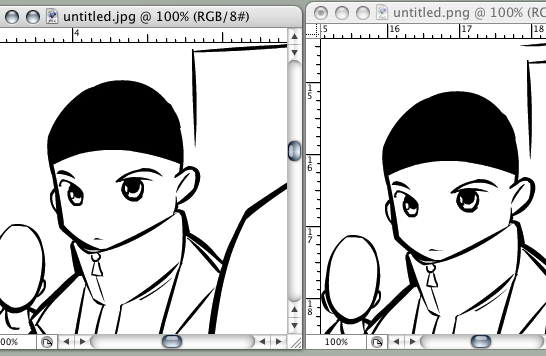

« Reply #34 on: January 24, 2006, 08:44:39 AM »
You say that you export the ink layer from Flash as a 300dpi JPEG.  The inks certainly look grayscale, so why not save it in something that isn't quite so lossy, like PNG?  I have found that compresses great when you have a clean grayscale source.
if you're talking about the faded gray marks in the background, thats the original sketch.
That's not quite what I meant.  I mean, if there's no color at this stage, why not export the inks as a lossless format, rather than using a lossy one?  With no color at this stage, a PNG would have comparable filesize to a JPEG at maximum quality, without the issues associated with most JPEG renderers.  Using JPEG at this intermediate stage just doesn't seem to make sense to me.
i really dont understand why you're so worried about the quality loss at this stage right now.
the window on the left is the ink at 100% - 300dpi - JPG
the window on the right is the ink at 100% - 300dpi - PNG
I even saved the screenshot as a PNG.

« Reply #35 on: January 24, 2006, 09:09:31 AM »
(image)
I suppose the quality loss isn't really a concern, looking at that - especially after coloring.  But if you keep the ink layers, I still think PNG would make more sense - I'm almost willing to bet the PNG shown above has a smaller filesize than the JPEG.  (Of course, you'd probably just keep the original Flash files instead of an exported image...)

« Reply #36 on: January 24, 2006, 09:21:08 AM »
(image)
yes i keep everything. when i export the line art, i still have the flash file shaved. when i finish coloring the comic, merge all the layers and publish it online, i still have the original psd file with layers.
